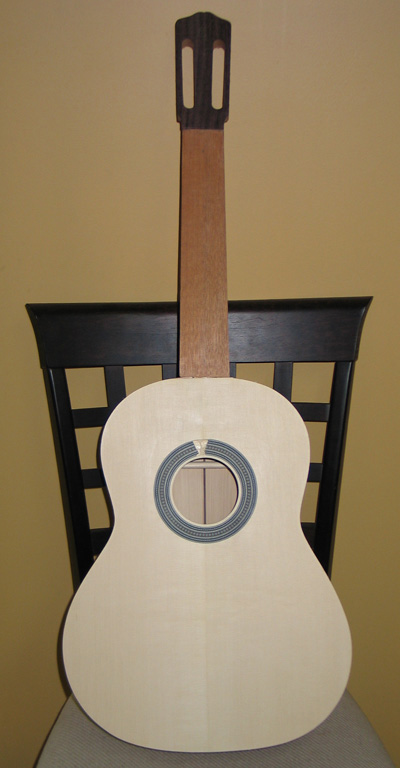

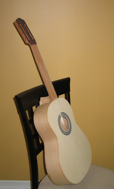

Hello fellows,
been a while since I posted my first bracing pics. I've been working every week-ends ever since, except for one time I completly cracked up on side and had to reorder a set . Anyways, building this thing up, swearing once in a while , I can finally say that it looks like a guitar. I closed the back and trimmed the overhangs yesterday. I'm quite proud, but not statisfied... I've done plenty of avoidable mistakes and I hopefully wont repeat them in the future. I also didn't respect the plans carefully. My sides are a little higher than intended. Depth at the heel/peak/tail are 90/94.5/99mm instead of 87/91.5/95 according to the Santos Hernandez 1933 plans.
Here are some pics... and I'll post some questions below as I need some guidance.
So, next week-end, I want to route the purfling and binding ledge. I have the StewMac bit and bearings kit. But I have some questions about the bindings size. Mines are from the LMII serviced flamenco kit and made of Indian Rosewood. The thing is, they are as thick as the sides. Is that normal? I've also heard that with that StewMac kit, you had to route the purfling first, why is that so?
Best Regards,
PostPosted: Tue Oct 10, 2006 2:38 am
Its normal for the bindings to be as thick or thicker than the sides. What you want to do is determine how thick you want them and cut your binding ledge to that size, glue them in full thickness and scrap flush.
As for top purflings, I always cut that ledge first, then the binding ledge.
Hope this helps
By the way, your guitar is lookin Great!
Posts: 960
Location: Northern Ireland
First name: Martin
Last Name: Edwards
[QUOTE=DoctorX2k2] I'm quite proud, but not statisfied... I've done plenty of avoidable mistakes and I hopefully wont repeat them in the future. I also didn't respect the plans carefully. My sides are a little higher than intended.
yup, been there, done that!!
[QUOTE=DoctorX2k2]The thing is, they are as thick as the sides. Is that normal? [/QUOTE]
yup. the binding channel often cuts all the side away and the linings are visible. Not an issue.
[QUOTE=DoctorX2k2]I've also heard that with that StewMac kit, you had to route the purfling first, why is that so?
I'm guessing that it's to give the bearing a true side to roll along to cut a consistant depth. If you go to strwmac's site they have all the instructions for their kits as free downloads.

PostPosted: Tue Oct 10, 2006 3:12 am
Are you sure you need guidance? My oh my, it looks awesome and neat already!
Like Lance,I cut the purfling ledge first also, i think it's easier that way because you don't have the binding ledge in the way, preventing you to index fully from the sides but someone else might have a more intelligent answer!
Nice job Alexandre, Bravo mon homme!
